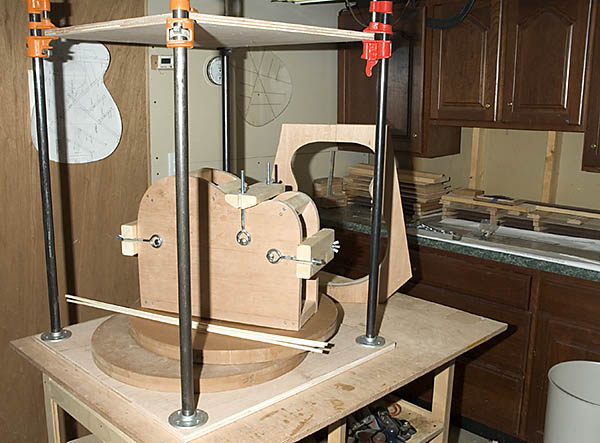

I’ve spent the last several weeks constructing the basic jigs and sanding bowls. A pic of my small basement shop area and my jig progress to date is attached.

your fixture setup looks good You will discover this own your own or you could take some friendly ad vice and laminate another piece of 3/4 ply to the top of you go-bar-deck. the tension on the bars will deform 3/4 ply pretty quick

One suggestion on your go-bar deck: I would add another 3/4" layer to the top (glued together) to discourage flexing.

Hey, great idea with the pipe clamp adjustable top on the go bar deck. Is that your idea? First time I've seen it. This is why I love the OLF, you get to see stuff like this. Love it.

Thanks for all the suggestions. Michael and Ron - I was also wondering about the stiffness of a single plywood sheet for the go bar deck top. I’ll laminate on a second layer before I load it up.   Dickey – I think I saw the pipe clamp go bar deck supports on Kathy Matsushita’s site. I already has some pipe clamps so it was a good design solution for me.

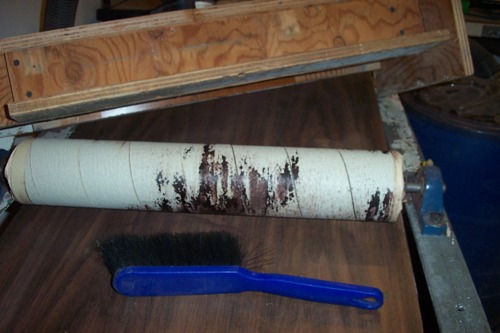

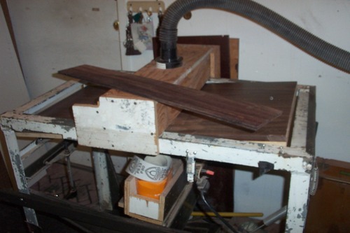

PostPosted: Thu Aug 24, 2006 4:01 pm
My home made drum sander! i just lift the lid, clamp the vacuum hose next to the drum and i work/sand to the lines, i also use rasps and strips of 80 grit sandpaper
Others would use a lancelot blade on a grinder but most traditionalists would probably use a drawknife for this application. I found that a good cabinet scraper is a must towards the end...

Argh, Michael beat me to it. I was going to suggest that as well. Your fiberglass rods will stretch that single ply to its limit. They exert a heckuva lot more force than one would think. Even with 2, you can really push it.
I really dig your moveable clamp system, though, for the deck height. Very nice.
